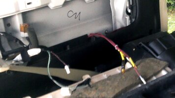

Thanks for all your help. I've installed a 12v socket, voltmeter and two usb chargers into the single din enclosure where the dvd/satnav was, and another 12v socket and usb/aux input for my soon-to-be head unit above the popout drinks holder on the passenger side. Theres enough space there to drill through. Both inline fused and powered by the 12v accessory feed that went to the electronic toll reader. Starting to feel quite 21st century!

Switched 12 volt socket, dual usb charging socket and voltmeter in the glovebox running on the accessory circuit - and usb/aux inputs for the headunit and another 12v socket set into the side of the centre column

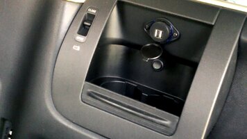

And, for extra points, switched lighted dual usb chargers in each of the rear cupholders (not wired in yet)

Just a tip if anyone does the same with usb in rear cupholders.....
i had to lower the switches (now mounted on the plastic partition between cup holder cavities) as there is a metal protrusion higher up on the van walls, and they wouldn't fit.
